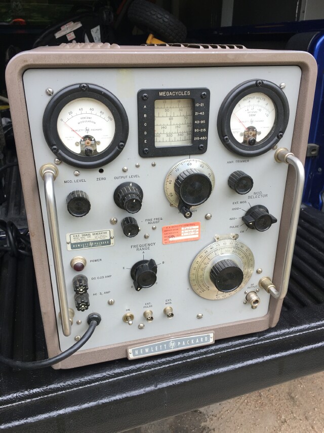

I really don't need it, but I like how it looks. And I am sure I can use it at some point. :lol:
It's in Tucson, and we are going there Saturday anyway.
Seller wants offers, one of those " if you are looking at this you know what it's worth" things. Well, I don't know. :oops:
Maybe a range from parts to good working condition?
Russ
Unless other wise noted, I am only interested in the electronics, not what it looks like. Thanks.

Saw a couple on Epay $150-$450.
You know that it weighs over 60 pounds and will take up a lot of realestate on the bench.
They are cool looking!

I agree with Jim, 40 bucks is a fair price today, they are mighty big generators, and only go down to ten megacycles.
They Were Great generators in their day, and I had one for 5 years or so back in the early 60s. If VHF/UHF is of interest to you it would be a good basic generator but you'd need a counter to get "on frequency".
If your interest is primarily HF, I'd recommend you get an HP-606.

"If you know what it is, you know what it's worth." Okay, I'll bite. I got rid of a couple of them a few years ago and best offer at swap meets was $25.00 And that was with manuals! Aside from size and weight, the big limitation is that these are AM and CW modulation only. No FM or sweep, which puts them out of the running for many of the things you'd want a VHF generator for today. Also, they used sealed meters which may have been fine 50 years ago but are often bad or erratic today.

No way would I touch any 608 model without knowing that both the oscillator and RF amplifier tubes were OK. They could cost hundreds of dollars each to replace. Then there's the practical use; the lowest frequency output is 10 MC. If you are working on broadcast radios, a 608 is useless. My recommendation is to wait for a 606 to show up, preferably a 606B. The 606A has the probability of needing not only the RF tubes, but the series regulator tubes also. If you can afford one, an 8640B is a great generator to have; with a simple resetting of the frequency stops, you can take it down to 455KC.

The important thing is what a 608 can't do for a hobbyist. Its frequency range is 10 to ~ 400 MHz. If you need a generator that provides frequencies below 10 MHz, look for a 606 !

I did buy it for $60.
Unfortunately it went directly to my storage unit for now. Didn't even get to open it up.
