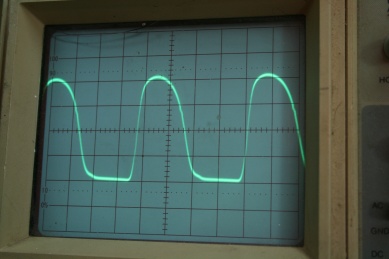

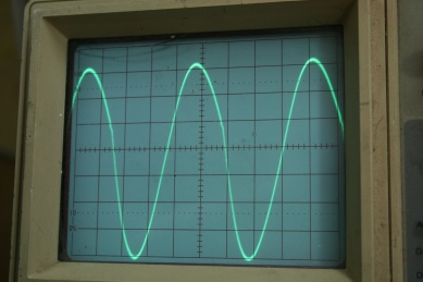

Other topics here include Model 324 output waveforms. Members reply that the nasty looking output waveforms are normal for the 324. The input to the cathode follower is a nearly perfect sine wave, so the distortion is coming after that. In an effort to isolate the distortion source, I replaced the B+ RF blocker cap with an electrolytic. This cleaned up the output some; and now you can see from the photo what distortion is directly caused by the cathode follower. My waveform with the normal RF blocker (1000 pF) is pretty much the same as everyone else's.
Has anyone reworked the cathode follower or maybe the B+ (it's only 54V) to fix the output waveform?
Yes, I know I can't leave the electrolytic there because it pretty much kills any AF modulation - I'm trying to fix one issue at a time,
Here is my 324's cathode follower input (V2, pin 2) and output waveform (V2, pin 3) with a 100 uF electrolytic B+ RF blocker on the final cathode follower (V2, pin 1 to ground):

You had the answer here:
You don't WANT to fix this---the output is supposed to be distorted---that's how the higher frequencies are generated

In general, service grade generators use simple designs that are not optimized to do anything more than provide basic signals for troubleshooting and alignment. The waveforms posted by the OP are normal for the 324.
I haven't looked at it in any detail but the distortion is most likely caused by over-driving the buffer stage. Preventing this at all frequencies generated may not be easy.
The 324 only depends on harmonics for the top band. Band F2 (110-435 MHz) is made from the third harmonic of the F1 (37-145 MHz band. All the other bands use fundamentals.

If you want to clean up one of these signal generators, simply connect it to a tuned circuit at the desired RF or IF frequency, the way it is meant to be loaded when it is connected to the RF or IF stages of a radio. That will remove much of the harmonic content from the output.
The problem with randomly swapping capacitors like this is, above its self resonant frequency that electrolytic is going to turn into an inductor which will cause the circuit to lose gain or generate even stranger waveforms, if it works at all. The 324 was optimized to do what it does; you may be able to "fix one problem at a time" but you'll never get done because everything you "fix" will be at the expense of something else. If you need a low distortion RF signal generator for some reason it would be more satisfactory to sell the Eico and buy an old HP, GR, Boonton, or Measurements Corp. unit which is already closer to what you want, and refurbish it.
This is a little off topic but that's exactly what I did when I needed a 1 MHz sine wave to calibrate a wide-band VTVM. I Used my 324 and with a tuned circuit got the harmonics close to 50 db down.

Thanks for the replies so far, guys.
Chris108: Not sure where you got the idea I was randomly swapping capacitors. As I said, I know I can't leave an electrolytic in there for C5, but are you sure it's because of the reason you gave? C5 is not in the RF signal path. B+ blocking caps are pretty standard and a great idea except the 324 modulates the RF via the (seems crazy to me) RF section's B+. Shouldn't they have gone with a heptode there and left the B+ a nice DC? I guess keeping the manufacturing cost down won over standard design. Nevertheless, I am thinking C5 could be replaced with a better RF filter since all you really want getting to the plate, besides DC, is 400 Hz. You may be right that I should drop the 324 and get a different signal generator. I'm not there yet, and hope I don't get there. I can be pretty obsessive about design. 8^O
RRMan: That is what I was thinking. The input to the cathode follower is only 3.6 Vp-p, which shouldn't be an issue at all except for that (too low IMO) 54 V B+ and the 268 Ohm cathode to ground resistance (seems really low). Maybe once I'm done redesigning the RF buffer stage we can keep that nice oscillator sine wave all the way to the output jack (maybe lose band F2, but I think it would be worth it). Do you have experience building RF gear, maybe ham stuff? : )

If Eico wanted an electrolytic off the plate of the cathode follower stage, they could have put one there. What they used was a 1,000-pF ceramic disc capacitor which is an RF bypass--intended to function as a bypass to VHF frequencies. It is critical to prevent degeneration in the stage, and yes it is absolutely part of the RF circuitry. Read up on Miller capacitance if you don't believe this--that tube is coupling plenty of RF from grid to plate. Clearly removing audio frequency modulation in that part of the circuit was not part of the plan. Getting maximum usable output over a 150-kHz to 430-MHz frequency range was. "Usable" in the context of a kit signal generator aimed at hobbyists, hams, and TV repair shops, did not require, or include perfect, near-zero distortion sine wave output.
I certainly don't mean to discourage the experimenter spirit here. I think you should try different things and see what happens. That's what the electronics hobby is all about. But just bear in mind before you declare victory that about 60-65 years ago a group of pretty sharp guys in the Eico plant in Brooklyn, NY, tried to do exactly the same thing you are trying to do now, and a lot of clever people have been trying to improve on it since then without unqualified success. You might be able to clean up the waveform at one frequency, but that will likely come at the expense of performance at other frequencies.

If you really want to clean up the output I think you'll have better luck by doing a redesign rather than trying to modify the existing one. I'd start by ripping out all the RF stuff except the oscillator and go from there. Once you get a buffer stage that will pass the signal without distortion you can worry about modulation, an output stage and an attenuator . My gut feel is that you can probably get a decent waveform up to a couple of megahertz and with a lot of luck maybe even to 10. The chances of going all the way up to 145 is zilch.

The cathode follower would have been biased into conduction if they wanted a linear circuit. But a linear circuit won't MODULATE - feed two signals in and you'll get the same two signals out. To make it modulate, it has to run near cutoff so that one signal is switching the other one on and off. To make it multiply accurately, a much more complex circuit is required.
