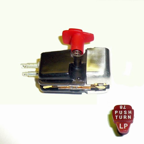

 Post subject: Re: Cartridge type for Newcomb TR1656M?
PostPosted: Feb Mon 12, 2018 6:09 pm
Posts: 2480
Location: Haledon NJ USA
If you look at the stylus of a GE VRII cartridge, the cantilever sits on a rubber block. This lets the stylus travel back and forth freely, but it really can't move up and down much.
PostPosted: Feb Mon 12, 2018 6:15 pm
Posts: 11987
Location: San Jose, CA USA
Very interesting! Thanks.
