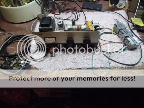

Hi, All-
I'm hoping for a few good suggestions on a Knight T-60 transmitter I'm repairing. It's working well enough with two replacement power supply electrolytics installed that I was able to get about 30 watts out, crystal controlled, on 40 meters. There is a problem in the area of the 6HF8 multiplier tube output circuit, however. Something is far enough off nominal values that the output peaks with the Drive Tune cap at full unmesh. I know that can't be right. I'd really expect the normal setting to be somewhere near half mesh. So far I have only tried the radio on 40m. BTW I hear this old novice Tx can do maybe 50 watts out on a fresh set of tubes.
There is a schematic online at the W9ZT website:
http://w9zt.bravehost.com/t-60page.htm
Scroll down the page a little.
Here's a direct link for the schematic if you prefer:
http://w9zt.bravehost.com/T-60schem.jpg
There is a better resolution schematic in the T-60 manual pdf on the bama archives site:
http://bama.edebris.com/download/knight/t60/t60_v6.pdf
Look on pdf page 32 (manual page 30).
I haven't yet had the time to sit down and really go over the wiring. This being a kit, it's certainly possible it was miswired by the original builder. I need to get that done- I just made copies of all the documentation last night. My one immediate hunch is that maybe the short length of shielded wire might have greatly increased in capacitance over the years? This is the wire that connects between the multiplier C/L matching network and the final amp grid. I see only a 10pF cap C10 across the grid of the 6DQ6B. That's not much, so perhaps aging shielded cable 'delta C' might be the problem? Anyway, any of you guys care to toss out your own hunches as to what to look for here?
My main hunch is 'wiring error', however. So far I have found and corrected where one of the pins of V1, the 6HF8 osc/mult, was not soldered, as well as the ground end of a disc cap connected to that pin.

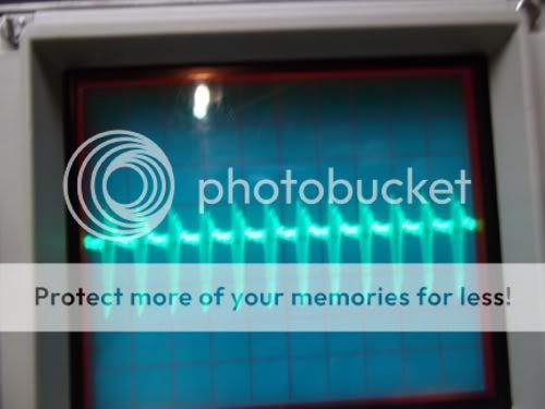

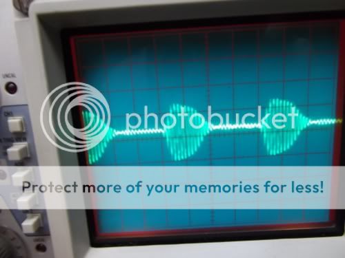

"Well isn't that special." Another interesting morning with the T-60. The fuzzy scope photo below shows what I found, regarding the instability I've been suspecting. I'd appreciate any comments as to where to look further. I'm guessing that, due to poor solder workmanship or wiring errors, perhaps some bypass cap shown on the schematic may not actually be in-circuit.
Please excuse my poor photography. You're rooking at my Tek scope with timebase set to 5us/div. What did they used to call this sort of thing- was it 'squegging'? Anyway, you're looking at a roughly 200KHz oscillation modulating the 7MHz envelope. If you detune the Drive Tune cap, the oscillation disappears and the output is lower, but at least 'clean'. Actually the sinusoid I saw with the LF not there was not all that pretty. If you adjust the timebase for .05us/div, you get about 2.8 divisions per cycle, so that part looks to be 7MHz, close enough.
BTW my takeoff point is at the junction of R23/24/25 with the Meter Sensitivity switch grounding R24. The scope input and triggering are AC coupled. So that's a voltage divider with 3.3K in series with 100 ohms. Using a 10x probe, I think the vertical sensitivity was 5V/div. If you scale up the ~13Vp-p by 34, the divider ratio, you get 442V, pretty close to the no load supply voltage. Comments?
Thanks, David
Clutter
 Post subject: Re: Help Troubleshooting Old Transmitter (T-60)
PostPosted: Dec Sun 11, 2011 4:12 pm
Joined: Jan Sun 18, 2009 5:13 am
Posts: 148
Location: Eatonton, GA
Clutter,
Your scope shows that your waveforms are living up to your user ID lol. Keep checking for poor solder connections. I still prefer lead-based Kester if you can find it. You're probably going to find a by-pass not really making a connection, as you mentioned, or perhaps a parasitic supressor not doing it's job. Maybe a leaky cap also. Your rig is not new anymore. Years ago I had a Meck T-60, almost nobody remembers Meck transmitters. It was an excellent radio in it's day, but when I got, it back in the 60s, it had more dried-out capacitors than I can remember. Good luck and please keep us posted. You know what they say; a smart man learns from his mistakes. . . A genius learns from other people's mistakes. CB
Craig

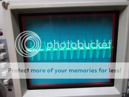

I've tried one more thing so far. C11, the cathode bypass on the 6DQ6B final, was a huge 600V brown mylar tubular cap. The radio originally had a .05uF disk there. I came up with a tiny .047uF 250V box type polyester and put that in. The squegging waveform became much more symmetrical (refer to the previous waveform above). The first photo shows the waveform with the same 5us/div as before, the second shows it blown up at 1us/div. A noticeable change, so I haven't ruled out the LF oscillator being the PA just yet. This is key down BTW, not a keying waveform. But it looks a little like one. Hilarious!
Based on this second waveform, it looks like the LF oscillation is actually a little closer to 250KHz than 200KHz. Comparing the first waveform in this set with the previously shown waveform above, I'd even say it looks like this capacitor change might have moved the LF up just a little. 12 pulses on screen previously, 13 visible in this set. I'm not sure, though.

Clutter,
You should be able to hear a harmonic on a portable AM radio and get a pretty good idea of the freq. BTW, check your email. I sent you a note about the Meck. CB
