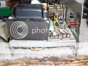

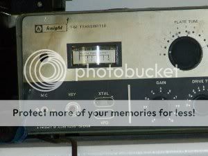

Thanks, All-
I'm getting some great suggestions here. I had this small insight today...
Considering that this is a basically working transmitter provided one carefully detunes the Drive Tune just a little, and it shows 30 watts output on the Heath HM-2140 wattmeter even detuned...
I noted with great interest that when I put my DMM on V1 pins 3 and 9, which are the oscillator and multiplier plates, I saw 520V both places. That's right, it's the same as the 6DQ6B final plate voltage, for crying out loud! Yikes! Perhaps this is normal, however- this was measured key up. Need to get a better sense of whether the electrode voltages make sense in those stages. Looks like I'm dealing with series dropping resistors and not dividers here.
(Sigh...) I'm embarrassed I had overlooked this most basic of tests up until now. :oops: But still these may be normal readings. The work ahead is to restore the correct B+ distribution in any case. It stands to reason that a number of caps should be replaced on general principles. It is looking like one of the decoupling caps somewhere on the B+ might be the culprit. BTW there are no tubular type caps at all in the affected circuitry. Everything is disks there.

The oscillator and multiplier voltages proved hard to pin down with the DMM, even on the supply side of the RF chokes- RF effects on the meter. I'll try later with a 2:1 resistive divider to bring the voltages within my scopes 50V/div so I can look at them DC coupled. My impression so far is that they are probably close to normal.
Clutter

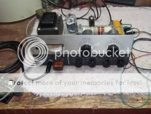

Good ideas- I'll try the additional electrolytic(s) for decoupling near the driver. For the PA, at least, I think those ground points are pretty well separated. Will take a relook at that. I'll also try an additional L + C section to the B+ feed to the driver, if the electro alone doesn't help.
Oh, one thing I should mention- the original RF chokes were 3 identical 5mH chokes. They are iron core, 3-pie types. Someone replaced the PA RF choke with one of those old, longer choke types, the ones with the ceramic body and massive metal end caps with radial leads. It is obvious from the puddle of wax beneath this choke that it got pretty hot at times. I figure this has to be a 2.5mH choke, as there is no powdered iron core. I may remove that non-standard choke and swap in one 5mH from below chassis. I have plenty of spare chokes, and do have some 5mH to replace what I borrow. I'd like to get that PA area back to being as original as possible. FWIW, as I worked on the radio, every little change I have made in the PA area has seemed to translate into less of a feeling of instability and less ugly waveforms, both in and out of the LF oscillation. The 'snap' noted when turning the Drive Tune has now noticeably diminished (but is still perceptibly there). My gut is still pointing me mainly towards that PA stage for the source of my problems. I'm not sure how easy it would be for an LF oscillation to originate in the driver and pass through the shuntC/ series L network feeding the PA grid. Perhaps not all that difficult. I guess that network must be basically a low pass?
I do think grounds are to be viewed with some suspicion in this radio. Again, too many mods by persons who apparently weren't thinking in terms of good RF design and layout.

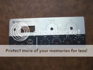

It is kind of late here now and I may have missed a fix, but you say that the 5mh choke in the final plate was removed and replaced with a 2.5mh choke.
The low frequency oscillation you see is probably a TPTG (tuned plate-tuned grid) oscillation with the chokes.
The old books said that the plate circuit must be tuned higher than the grid circuit to oscillate. (I am 71, and the books in the library were old when I was in high school).
Drop the Q on the driver choke with a parallel resistor for a test and see if the problem goes away.
If so, then you need a new choke in the plate.
There are people who make new panels. Or you can find someone that can make you a decal to put on a replacement panel.
The modulator may have been removed when someone told mama that junior was outside the novice band on AM.
