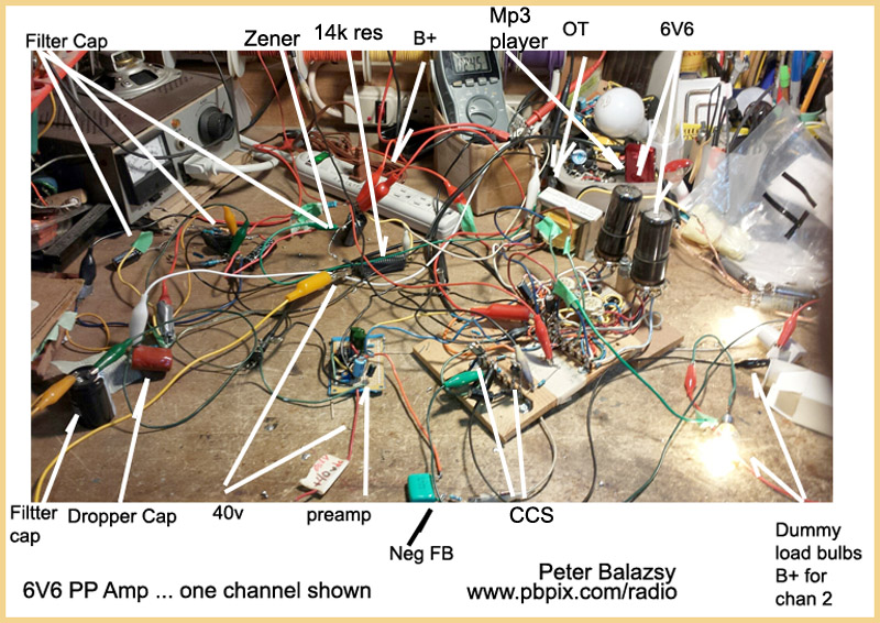

Tonight I modified my breadboard to add some octal sockets so that I could also test this amp with 6V6GT tubes.
It worked out alright. I can either plug in the 6AQ5 or the 6V6 ... one set at a time.
I don't know if it's psychological or what... but I get the immediate feeling that the 6V6 "seem" to offer more bass.
Anyway... I thought I'd post an image of this beauty ... just as it looks now on the bench in ALL its glory:

Nice work Peter. Looks like a labor of love. My wife was looking at your bread boarding for the kitchen sink. I appreciate your work.
Let me know about your chassy layout. I can do both.
I am just getting a parts list for this amp, for Mouser. I think the dropper cap is a good deal on ebay.
Thinking about the box or chassis. It must have some bling.

Looking more at your test setup Peter.
Learning so much by seeing your technique.
Thanks again....
