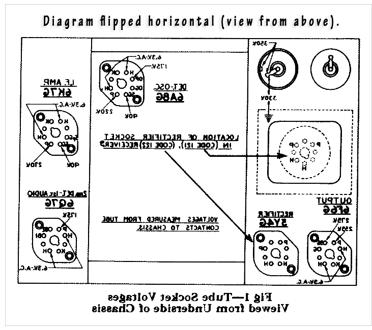

A schematic for Philco 37-610 can be found at Nostalgia air.
http://www.nostalgiaair.org/Resources/
Direct link→ http://www.nostalgiaair.org/Resources/199/M0013199.htm
Your chassis (tube layout) label is somewhat confusing!
Maybe some one will chime in.
Welcome aboard... :)

Not sure what happened, Greg, but your link goes to a 37-116.
Here is the link I found.
http://www.nostalgiaair.org/pagesbymode ... 013209.pdf
