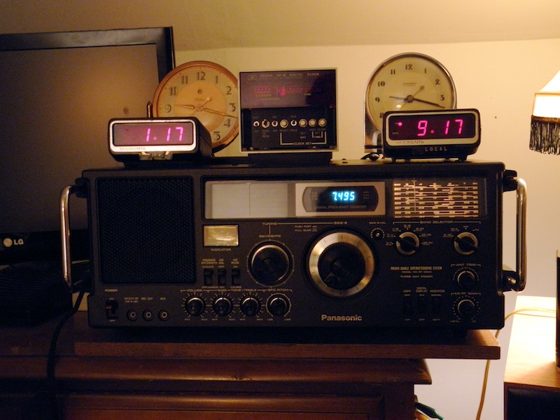

Very cool there John! I never had a 2200, but I had a 2800 and a 3100 that I still have. Bought it new. I fired it up a couple of months ago and while all the controls seem to work fine with no scratchiness, it has a lot more "birdies" than I remember. Maybe I'll get around to figuring it out before I pass on to the great beyond!

Matt, that is a good looking radio. How does it compare with the 2200, feature-wise?

Feature-wise they're pretty much the same. The RF-3100 has a DRO and breaks SW down into 29 distinct 1 MHz band segments extending from 1 to 30 MHz. But the RF-2200 has a rotatable MW antenna which helps a lot when chasing MW DX or for just listening to MW for that matter.

The Digital ReadOut on the 3100 is a great convenience. Shotwave performance is much better with my 3100 than with my 2200, FM performance is nearly equal but the AM band, while adequate, is not nearly as good as it is on my 2200. The RF-3100 has a completely different "feel" to it compared with the 2200. I like both radios.

This thread revived my interest in my 3100. As it turned out the "birdies" I was hearing were due to my Bose wireless Bluetooth speaker in close proximity to it. The Bose was turned off and on battery power, but apparently the circuitry was still live. WTH is it doing while it's turned off and on battery power?
I agree with Dave's overall consensus. I never considered it to be a serious contender on MW due to it's large footprint and fixed ferrite antenna. Rotating the thing around to receive a signal is totally impractical. However it is still very good for SW reception! 36 years old and the thing is right-on frequency-wise on every band and extremely stable during SSB reception!
