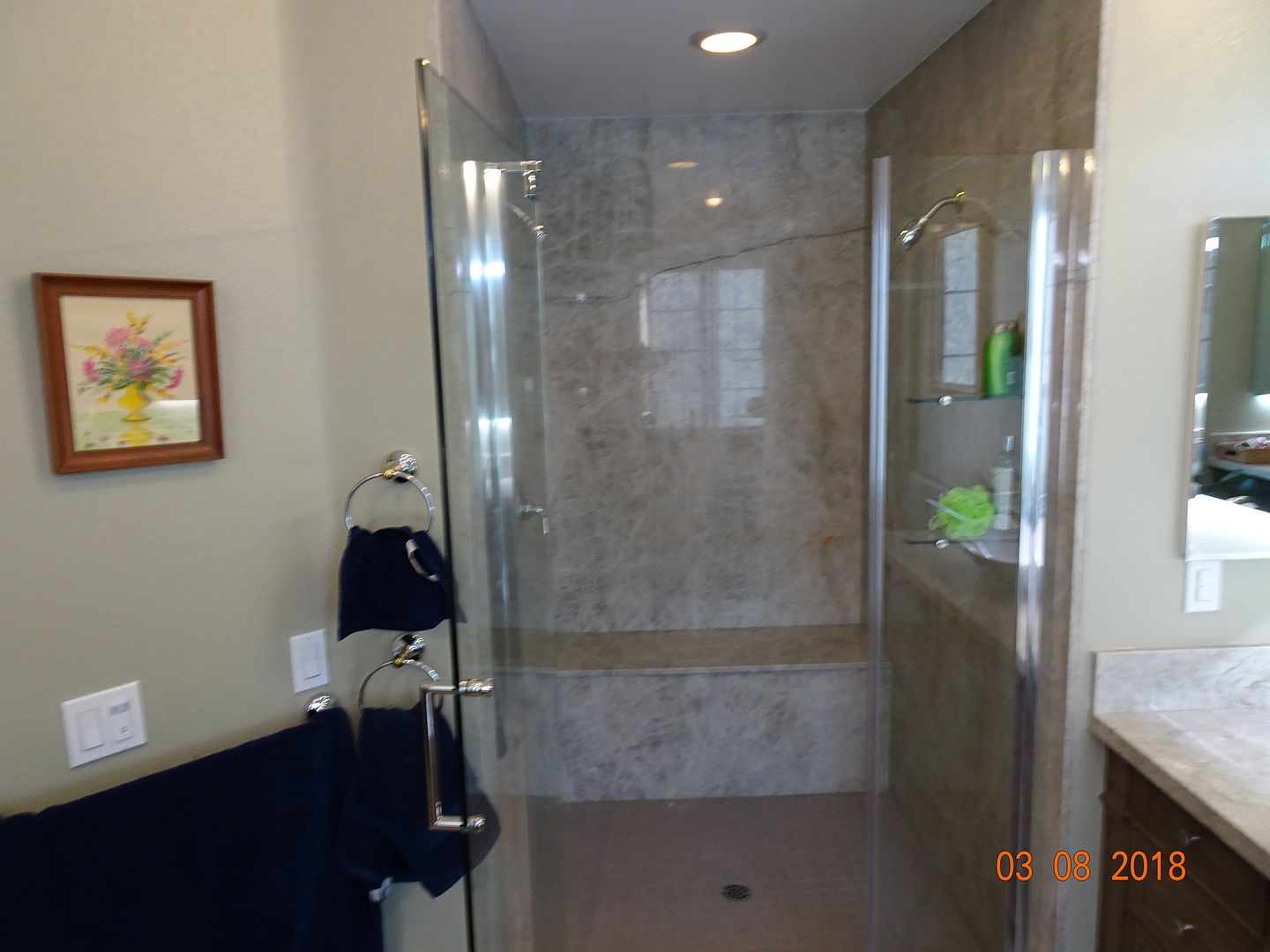

The quartzite in the shower. I had to drill 17 holes in the quartzite to mount the shower door assembly. Next time, the contractors can do that..

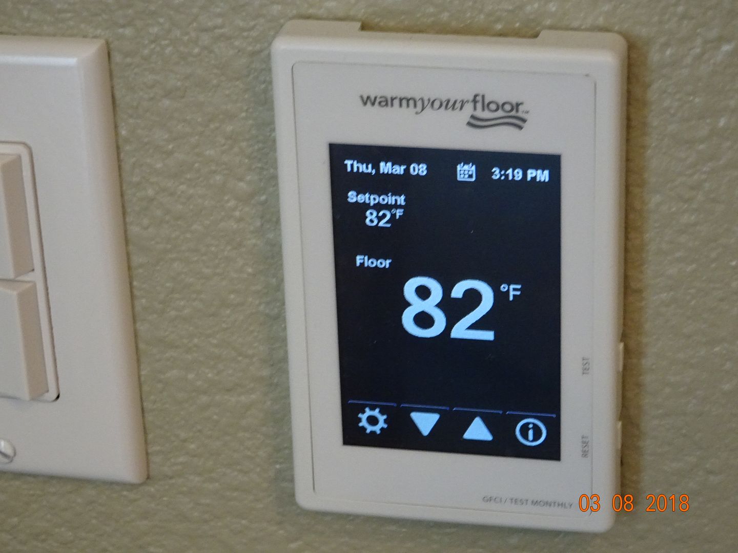

The heated floor is much nicer than the old electric space heater we had been using on cooler mornings

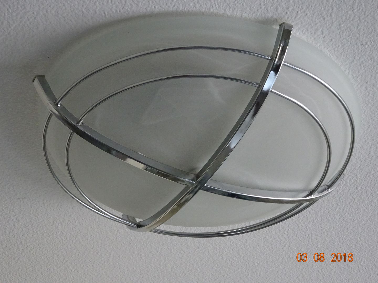

This is the fan - light which does not at all look like a fan. It is controlled by a humidistat, so comes on as needed.

Just one thing. Do you have a doorstop on that shower door? I just wonder about those things when I see them. Heavy plate glass on 2 small hinges.

The shower door does not need a stop. The stone is plumb, as is the door frame, so it will stay open at any position past 1/2 open, and will be stopped by the towel holders if opened all of the way. It soft closes at positions less than 1/2 open. We got bids as high as $2,000 for custom shower doors with 1/2" glass, but decided to buy this door with 3/8" glass from Home Depot. I also did not want the high localized loads of the frameless designs with two hinges. That stone was expensive....

Looks great, Stephen! Very custom! Umm, what's that horizontal black mark on the back marble slab in the shower? Not a crack I hope?

The line in the quartzite is part of the natural color in the stone. By buying three slabs, we were able to match that line on the three sides of the shower. It is interesting to look at the stone and see all of the various color and features.
