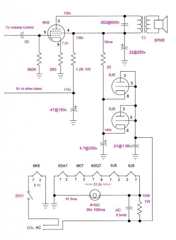

Diode?? The two 6J5 are acting as halfwave rectifier, plate & grid tied together... Schematic has complete heater string with dropper cap, B+ & audio output circuitry... This set originally used a resistance line cord... Excepting for tubes, runs cool with no heat...
The 6K6 is somewhat audio challenged as B+ is approx half of recommended, still it plays louder than I need... I was determined to use original type tubes, Don(Bike & Swim)and I bounced ideas back and forth till the circuitry was finalized...
BTW I didn't draw RF circuitry as otherwise it's AA5...

Doh, I didn't notice the grids and plates tied together. :o
I have saved your schematic to my files, thanks.
Also saved the schematic in this thread, interesting.
