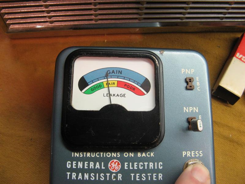

Radio had moderate distortion but voltages from 1st IF to audio outputs were spot on. I then fed RF out(detector) to external amp, A-OK. Next coupled AM/FM tuner to radio output, definitely amp issue. I'd been somewhat mystified as weak signal seemed to amplify(pun) the issue. Fired up scope & looked at audio feed from driver transformer to outputs, clearly one had issues. Gain approx 75% of other. Said to self, "driver xfomer isn't likely the problem, pull that output".
Using my handy dandy 1956 GE transistor tester, testing gain here's what I found.
Replaced transistor and bingo, distortion gone. Of course I had to test the other output, better but not great gain.
Also worth noting both outputs had only slight leakage.
BTW code dates on both transistors approx 10 months to one year newer than radio, serviced early in it's life.

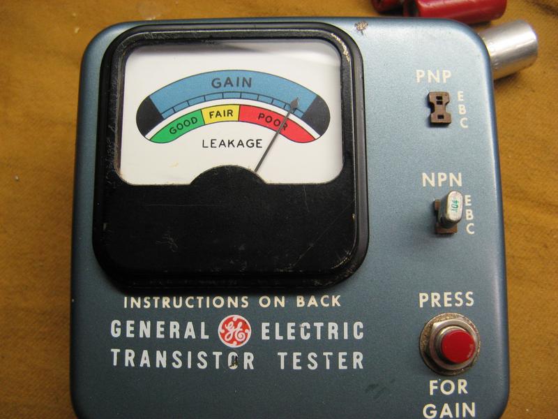

In case anyone is interested in gain of NOS RCA SK-3010 replacements, not matched pair but both approx same.
