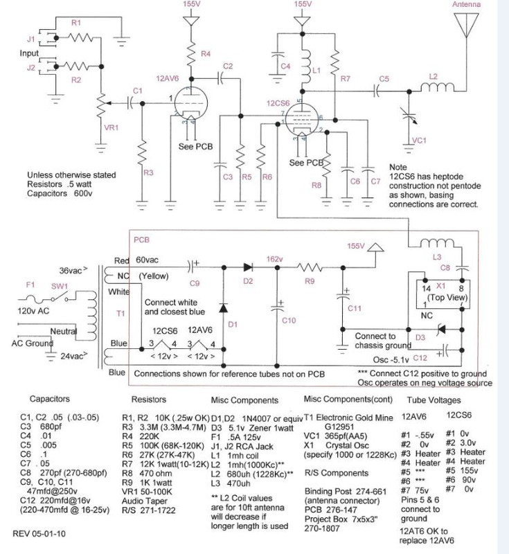

As far as power transformer, is that 67v from tap to each leg or 67v across both legs?? If so a voltage doubler would no doubt work, I used one in the 12SC6 xmit. Transformer for it had 36 & 24v windings that were connected series, then applied to a doubler. Using 1N4007 rectifiers, that 60v produced approx 160v B+. All that's needed for doubler is one additional rectifier and filter cap.

35Z5 that’s a great idea. I believe the transformer is 67V across both legs. It’s the 9-80-120 transformer on this schematic, which produces +/- 45V after going through a bridge rectifier:

On your schematic, I’m assuming C9 and D1 are the extra diode and capacitor?

Yes C9 & D1 are added for the doubler. D1 & C10 would normally be connected to ground but I needed a power source for crystal osc, so used the ground end for the 5v supply.
How are you planning on lighting the toob? That transformer has no 6.3 v output.

If you can come up with a 25v transformer could use that with a tripler, supplies around 105v. A 35v xformer & tripler would be over 140v.
