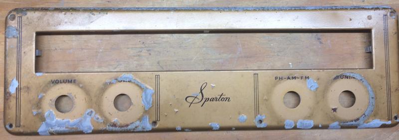

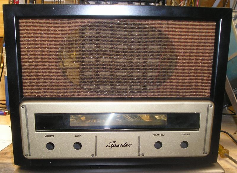

I’m in the process of restoring a “barn find” Sparton 141a radio and since allot of what I’m doing is new territory I hope a few of you can answer some of my refinishing questions for me and others who may someday be doing something similar. My first question is concerns what I guess would be called the faceplate which is shown by my photo. As you can see it was pretty roached out and I had to strip the paint off to bare metal and start again. What I’d like to know is how you would replicate the graphics and then install? The only method I could come up with is to use Microsoft Paint to make the lines and Word to make the lettering and then transferring it all to one Word document. I then printed this out on my inkjet printer onto clear decal paper, sprayed with three layers of clear acrylic paint the decal and cut out and installed them. After which I covered the decals and face plate with three more layers of clear acrylic paint. Thankfully, as you can see the clear acrylic didn’t react negatively with the base enamel paint on the face plate. I sadly was unable to replicate the graphic for the name Sparton and would really like to know if there is someway to replicate such graphic? If it was you how would you go about restoring these graphics and what programs and materials and such would you or have you used? If you use decals what is a good brand of transfer paper? I was less then pleased with the decal transfer paper I obtained off of Evil-Bay.

For the logo, it needs to be scanned and then redrawn using that as a template in a program like Adobe Illustrator. If you don't have the skills, you could hire someone fairly cheaply (https://freelancer.com).
Abetter way to recreate the printing would be to do it the same may the manufacturer did, screen printing. Unfortunately that's kind of expensive to do in the US.

Thanks for the reply. I'll take a look at your link you provided and check into the adobe program though I am kind of wondering how you can "scan" something as large as this faceplate photo I posted.

Thanks for the reply. I'll take a look at your link you provided at almost $300 Adobe Illustrator is kind of out of my and most casual users reach sadly. Also I wounder how how you can go about scanning something as large as this faceplate of the photo I posted? Surely many other people here have come across the same problem here and come up with cheap effective solutions?

If you have an old copy of Photoshop, it is no big deal. For accurate work all you need is a flat bed scanner set to scan at 600 dpi. Don't worry if the face plate is really big, just scan it in sections and piece it together in the photo editor. I then up-scale the image to 1200 dpi. This makes it really easy to overlay new text and trace graphics with extreme precision. As others mentioned, this image becomes a template layer. You don't even try to retouch the scanned image. You place your new text on new layers... When you get to a graphic, you just trace over the old one... The final step is to hide the template layer and merge your new layers... Presto :D Of course your good work is never going to look like the lithographed or silk screened original... But It will look pretty good...

Depends on the skill level and attention to detail one uses. It's just line art. Inkscape is an alternative to Illustrator. There are others as well. Years ago I could have done this quite easily, but don't have the computer, program, scanner, or screen printing supplies anymore.

Unless you have pretty good experience with Photoshop I would say its not as easy as made to sound. Yes! I've done it and it took patience, time and being a user for some years.
For the decal, you used acrylic lacquer which will probably be fine with the paint you used for the backplate providing that was acrylic as well (and ideally the same make). If not it may develop splits of a random pattern later. Happened to me. Looks good at first but then disappointment. Probably different shrink rates and maybe leave the base coat longer before lacquer.

Here's one done years ago as suggested, decals are under a lot of lacquer and can barely be identified, no splits.

Silkscreen: one colour / one screen, cost me £80 here :) . Every extra colour then add £20.
Can have half a dozen or more done for the same money though :D
