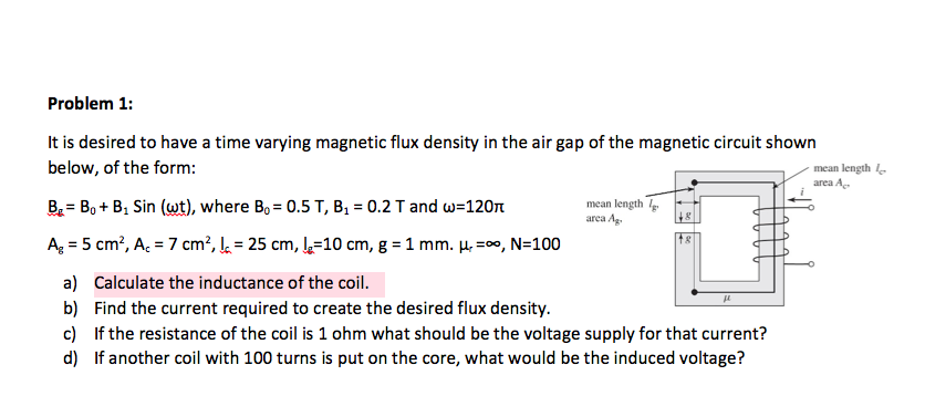

pixellany, The purpose of the transformer is to measure the efficiency of the laminate to divert a magnetic field. So it's not basically a transformer. Or probably wouldn't work well as one. I just want the laminate silicon steel because I think it would be a good carrier of magnetic waves.
I'll need to cut about 1/2" from the "C" or "I" side to place a magnet in the gap. Then I should be able to place a small compass on top of the other side to see how well it will point to the north pole of the magnet. Then I want to try different types of magnets to see which performs the best and at what gap differences.

This is not making sense to me......"magnetic waves"??......"divert a magnetic field"??
Maybe you could tell us what the end goal is......

Pixellany, yes, I kind of got the idea you don't understand what I'm saying. Mostly because you literally said you don't understand what I'm saying. My intent here was to find a good size transformer core for my experimental project, which I actually drew a picture of. Since I have a little time though, I'll be happy to better explain the fundamentals to you.
A laminated core is a device that is mostly used in electrical transformers. I need one for an experiment that I'm working on. My experiment does not involve transformation. Cores can be built rom many different materials and in different shapes. My experiment is currently designed to use insulated laminations of silicon steel. The reason I chose this material is it's ability to operate steadily at certain variating temperatures while minimizing resistance in the form of eddy currents and other factors. Although most recently I decided that a powdered iron core could also meet my requirements.
A transformer converts electrical energy into magnetic waves through the use of an insulated and continuous electric wire (usually copper) which is wrapped as a coil around an iron/ferrite material popularly known as a "core".
The electric coated wire passes an alternating current. The alternating current in the coil causes the transformer core to create equal and opposite MAGNETIC WAVES. That's why it's called a transformer. It "transforms" alternating current into magnetic waves. It's pretty cool. I'm surprised they didn't explain that in your training.
But wait! The fun doesn't stop there. Because if you take another, second wire which has no electricity in it at all and coil it around the other side of the core then the magnetic waves that are traveling through the core will actually induce an electric current into the second wire! Which makes it a double transformer! One side of the core transforms an AC current into magnetic waves, and the other side of the core transforms those magnetic waves into an alternating electric current. It is a perfect symbiotic relationship! I suppose that's why I'm so drawn to it.
Honestly, I'm not sure exactly where your disconnect is but I suspect it is this: Did you know that transformer cores carry magnetic waves? Because they do. If you take an "I" core of (oh, say about a 6" length of ferrous material) and put magnets on either end (both in south to north flow), and then place a small compass on top of the "I" core, you will see that the compass will change itself to point and follow the magnetic waves to the north flow of the magnets. I'll draw another picture.

Wow!!---- a lot of stuff there.
Part of the confusion is the choice of words---some of your terminology is non-standard.
First, we normally talk about magnetic fields. Maxwell's equations describe the propagation of electro-magnetic waves, in which there are alternating magnetic and electric fields. However, in transformers and coils, we deal with magnetic fields---not waves.
The alternating current in the coil causes the transformer core to create equal and opposite MAGNETIC WAVES. That's why it's called a transformer. It "transforms" alternating current into magnetic waves. It's pretty cool.....
No....
Start with a COIL---it generates a magnetic FIELD, based on either DC or AC current**. The magnetic "forcing function" is the product of current and the number of turns, and the actual FIELD produced is a function of the permeability of the core. Another semantic bit here: The core can be thought of as focussing or concentrating the field---not "diverting" it.
A TRANSFORMER has a minimum of 2 windings, and is used to "transform" either the applied voltage or current (which must be AC). We also speak of "impedance transformation"--eg in an output transformer.
No again: two windings makes it a transformer. One winding makes is a simple coil--also variously called a solenoid or choke.
And another NO....
A conductor is defined as something with enough free electrons to support the propagation of an electric field. In spite of the popular water flow analogy, the electrons do not "flow" from one end of the wire to the other, and they certainly do not "shoot out" from the wire along the way.
I assure you that all of this was very well covered---BSEE (Caiif State Polytechnic University, 1968, with follow-on extension courses........and you?
**Side note: Wave motion--whether it be sound or E-M--is, by defintion, AC only. Magnetic fields can be AC or DC.
