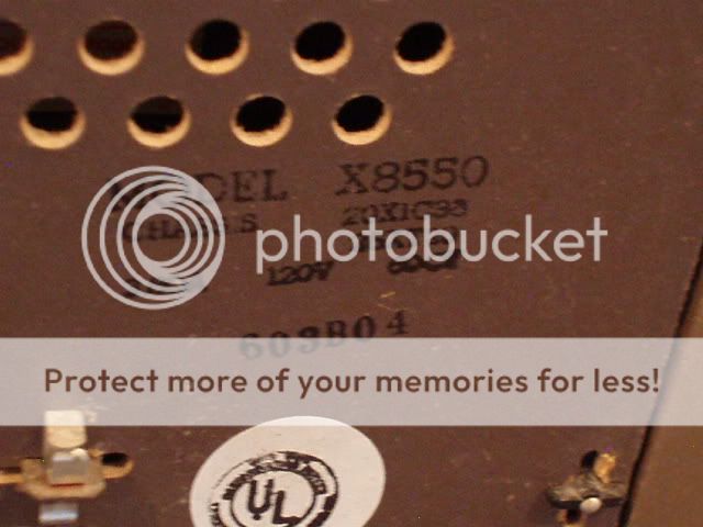

Just saved this unit, and am wondering if anyone here knows anything about this? It was my gradmothers and was no one else wanted it. It was headed to the dump and I couldn't watch it get thrown away.
The cabinet is really pretty. I don't know if the tv works or not. The stereo works and the phonograph works as well.
Anyone know anything about an old Zenith?

Made in 1967.
