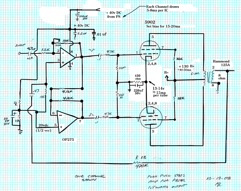

Here's the schematic that I'm following.
(EDIT update the latest version of the schematic can be found on page 6 near the end of this thread ) or here: http://www.balazsy.com/radio/5902/Peter ... nal-2B.png
The only change that I made was to replace the individual cathode bias resistors and by-pass caps with a single common cathode bias resistor of 420 ohms.
I don't know if I should be using a bypass cap in the cathode resistor here or not.
I thought Norm Leal indicated that with a single common cathode resistor that by-pass caps aren't needed.
Any ideas?

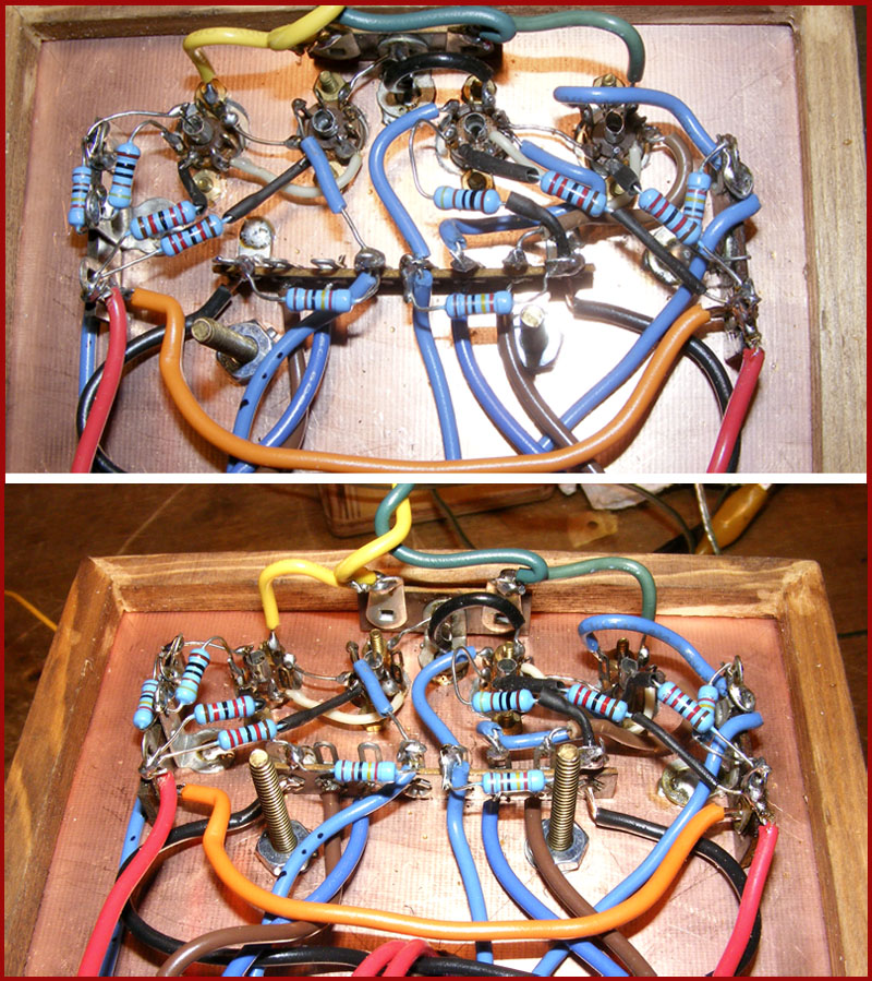

Here's my finished assembly of BOTH preamp channels on a single tiny 3"x2" perf board from Radio-Shack.
I'm not used to working so small since we usually are digging around these 1940s radios where EVERYthing is ginormous comparatively speaking.
So I simply put on an extra pair of eye-glasses and cranked my solder iron temp back a bit and came up with this little crowded circuit.
I know it seems like there's a lot more stuff on there than the schematic indicates... but I now believe that the schematic was just meant to "trap" you into thinking it's a simple little project!...lol

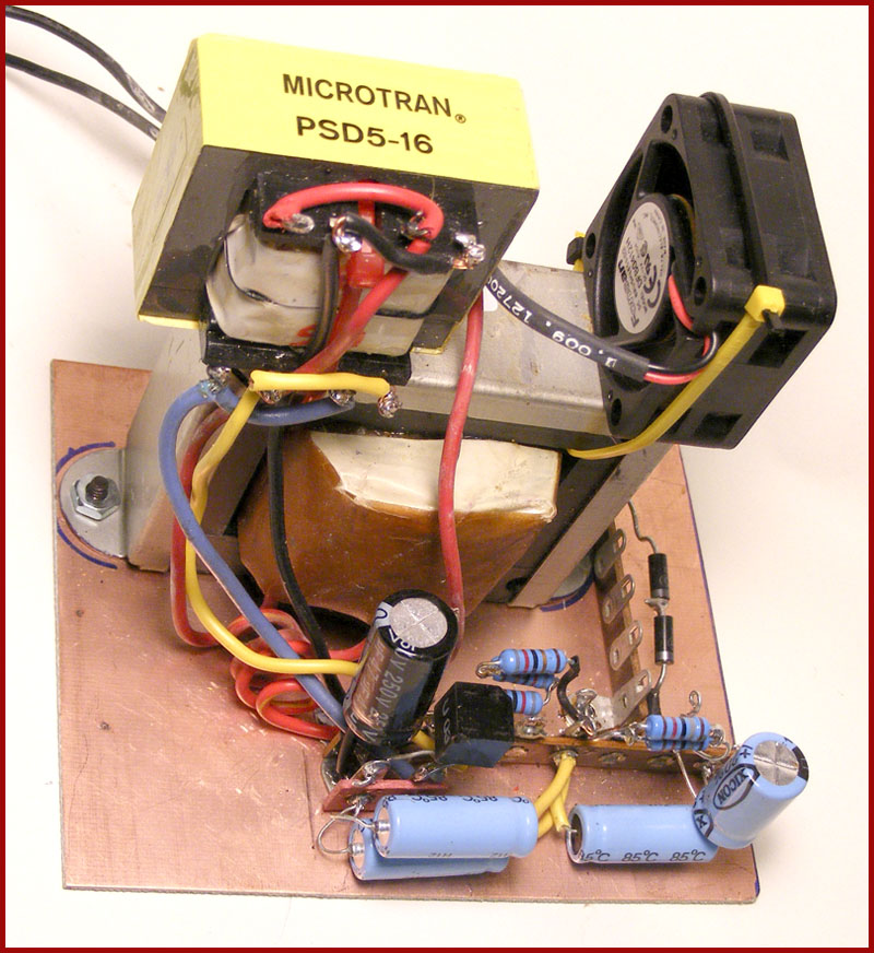

Here's the assembled power supply. It seems to run a bit hot (especially the step-up transformer) and so I added a fan to keep it cool.
The total B+ current is only about 80ma and then there's another 15ma feeding the 40v Zener and op-amp loads.
I would rather not have a design requiring a fan but I want to house it in the same wooden box under the tube circuit-board if possible, so I think a fan will be required to circulate air around and out the bottom vent hole anyway.
But here is where I'm open to ideas.
I chose the 2amp Triad 115v/25v CT because I bought a 1/2 dozen of these on sale last year for about $2 each. It seemed like a good beginning.
I needed a source of filament voltage for the four 6.3 volt 450ma tubes ... as well as two other voltages.
1. B+ = 150v
2. Vcc for the pre amp = 40Vdc
Then I bought the Tamura dual-wound 1.6 amp 8v/115v transformer (3fd-516)
http://www.tamuracorp.com/clientuploads ... FD-5XX.pdf
because I had to step up again to get to my 155 B+
The 8volts is actually 9volts unloaded... so that calculates to roughly about a 13:1 ratio (115/9=12.7)
The Triad will actually put out about 28v CT with a typical 125v input.
So I figured that from CT to one side = 14v x 12.7 ratio = 177v .. or there about.
And that's what I get.
However after thinking about balancing transformer loads.. I decided to leave the 115v windings in parallel... but I put the two 8v windings in series to 16v... because I felt that I'd be drawing a more balanced load from the Triad by taking the whole 28v output.
So that still works out the same :
Since the 8 volt winding unloaded = 9v that means with both 8v windings in series (16v) ... then I'd actually have 18v unloaded.
( 115v/18v= 6.3:1 ratio.... and using the full 28v out from the Triad secondary = 28 x 6.3 = 176v )

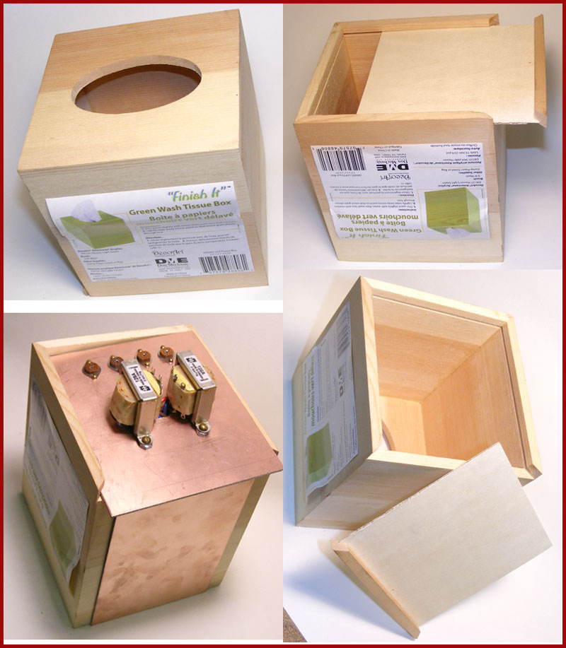

I ordered up some copper-clad PC board and cut it to the size I needed for the box of my choice that I'd be using to house the amp.
I was able to cut the board with a hacksaw with relative ease.
I had a devil of a time finding some sub-miniature tube sockets and finally found 6 or 8 of them at some remote place on-line and had to pay over$4 per socket plus shipping!
The 5902 tubes themselves, ( also quite scarce) were supplied to me by a very kind fellow ARFer for shipping costs.
Drilling the holes for the sockets was a bit tough for me. I bought the largest drill bit that would fit in my drill chuck. However my chuck doesn't hold very well so it kept coming loose.
Then I still had to ream each hole a bit afterward for the correct fit. I needed #2/56 screws to hold 'em in place so that meant 8 more tiny holes to drill.
Boy do I wish I had a nice drill press...lol
I decided to run all of the output transformer wires through one common center hole. That meant mounting them slightly above the board with a nut as a spacer and then I routed the primary wires under the transformers.
Quite luckily, I found a pretty good box at the craft store for only $1.
It's a nice little Chinese-made wooden tissue box cover with a sliding removable bottom panel.
It seemed great to simply turn it over and remove the bottom panel and instead I could slide in MY copper board. That puts the oval tissue-box hole on the bottom making for a great exit-way for wires and airflow.
I will be mounting the power switch and audio in/out jacks on another small copper panel on the front-side of the box.
The hardware will not mount properly through the thicker wood so I decided to cut away part of the wood front wall and I will mount another smaller copper panel from a hinge on the main board that will hang flat down against and be attached to the front wall with access to it from the cut away wood section behind it.
I also stained the wood box with some Minwax Special Walnut. It will later receive a nice top coat of polyurethane.

So, I installed the output transformers and inserted the tubes and fired it up. I didn't like the writing on the top of the Hammond transformers so I cut out some thin shiny brass covers for them to dress it up a little.
It seems to sound very nice at this point. I still have the little pre-amp board mounted external on the bench right now with long leads ....so everything isn't exactly optimized yet.
As far as heat goes... I would like to operate this, if I could, from wall-wart power sources to keep away all heat from the amp box.
I tried running the filaments from an external 13vDC 800ma wall-wart and it works perfectly... however, as odd as it seems, by removing that big 900ma load from the Triad transformer didn't really seem to cool things down very much at all.
Running with external filament power I find that both the Triad and the Tamura transformers still run hot without a fan.
With a fan connected however the extra filament load on the Triad doesn't seem to matter at all.
It runs very cool.... with a fan that is!
If I could come up with a nice simple way to get B+ from something the size of that 13vDC 800ma wall-wart I'd be happier.
Any ideas?

My only question is if the tubes and bases were challenging/expensive to procure, wouldn't it have been better to substitute a different tube?

About the cathode bypass cap, if the amp is operated purely class A, a bypass cap is not needed. In class B or AB operation it's best to use a bypass cap. In your case probably 100 uf would be fine. Try it and see if you can hear any difference. You probably will only notice a difference with the volume up near maximum.

1) I can't remember if you have a scope or not. With these home brew projects, a scope is extremely valuable tool which helps quickly troubleshoot problems. Being able to see the waveforms to observe distortion and clipping is very helpful.
2) Your stepup transformer (Tamura) in the power supply is overloaded. The heat issue alone tells me this. The transformer is rated for 12VA. With a 16v/115v ratio (~7.2:1), you should be getting about 205VAC on the output with a 28.6vac input. Since you are getting only 142vac on the output, this is another indication that the transformer is overloaded. At 205vac * ~0.1A load = 20.5VA, so I recommend switching the stepup transformer to one rated at least 25VA or more. This will keep the transformer cool. With the higher rated transformer, your secondary voltage will increase to about 205vac.
3) You are getting excessive ripple on the B+ due to C1 being too small. Another indication of this is that the B+ DC voltage is not high enough. This will result in a 60Hz hum in your amplifier. The capacitor should be large enough such that the B+ is not drooping between every half a cycle. A scope will show this clearly, although measuring the ripple with a AC voltmeter also works. I try to get the ripple below 0.1VAC (just my general rule of thumb) unless the supply is drawing over 2A. The DC level should be very close to the theoretical 1.414*(VAC from transformer - bridge rectifier voltage drop). Since the IR drop across the diodes is small, I'll ignore that. Thus you should be getting about a 142VAC * 1.414 = ~200VDC. Increasing C1 should get you close to this value.
4) The zener will work, but they don't give good power supply noise rejection. If you have hum problems with 60/120Hz still getting into your amplifier, switching to a voltage regulator will give you better rejection.
5) Just one suggestion on the amplifier section. For opamps, its always good to decouple the power/ground connections of the opamps very close to the opamp leads themselves using a capacitor, whose value is not critical and can be in the 0.01uF to 0.1uF range. I usually put these either right next to the opamp or solder them directly to the bottom of the board on the power/ground pins.

I agree with all your points except #3. Since this is a push pull output stage theoretically all even harmonics and PS hum are canceled. In practice there is never perfect balance so a bit of hum may exist, but you can get away with a fair amount of 120 Hz ripple on the +B to the output stage without objectionable hum. Obviously the +40 V for the op amps should be decoupled very well.
Also I would guess the 16V/115V transformer is saturated due to being overdriven by the 28V and is the cause of reduced output. This core loss is causing the excess heating.

On my power supply schematic you'll notice that I indicated that I measured 60mv PP ripple there at the 155v B+ point.
That is my ERROR though because it is ACTUALLY 600mv not 60mv. I was reading the wrong scale for the x10 probe..lol
My big goof.
I am sure you are right about the transformer being overloaded somewhat.. That excess heat is what surely tells us that.... right?
But I came about MY figures differently.
I was calculating the turns ratio based on the actual un-loaded voltage. So the 7.2:1 ratio (115/16 ) that you arrived at is based on 16v... but I learned (however accurate or not) from another PS design where the author stresses that the ratio should be calculated on the un-loaded voltage.
So in this case the unloaded voltage is roughly 18volts.
In my text I was using that figure. So 115/18 = 6.4 ratio
So 6.4 x 28volts = 179v
So do you feel I should still increase the first filter cap John?
You indicate that the ripple is too high on the B+ John.
I was thinking that 60mv pp ripple was extremely low.
But since it was a BIG ERROR and actually 600mv ... I guess you are right!
However I am not hearing ANY real noticable hum.
You said" I try to get the ripple below 0.1VAC (just my general rule of thumb)"
Updated:
So I have just now Added another 47uf at C1 for a total there of about 100uf for C1.... and I added another 200uf at C2 for a total of 268uf.
Now I get well below 100mv ripple there on the 155 B+ line
Thanks a lot about the de-coupling cap idea on the op-amps I'll try adding those tonight.

Peter,
That make total sense that the grid drive starts to flatten on the positive peak of the signal. The grid bias is about 16 V, so as soon as the positive peak value of the grid signal reaches 16 V, grid current will start to be drawn and this will prevent the signal from going much more positive. At this point you are producing the maximum undistorted power available before clipping, so sounds like this is just fine.
I am a bit concerned about the 16V/115V transformer you're using. When you drive a transformer with more voltage than it's rated for, the magnetic field in the core will most likely saturate the steel and this will cause excessive hysterisis and eddy current losses. The tip off is that the higher voltage side is much lower than would be expected from the turns ratio. You can always use less voltage on a transformer, but unless it was over designed in the first place, it's not a good idea to exceed the voltage rating. This is the same reason old PTs which were designed for 110 Vrms heat excessively when energized with modern 125 Vrms line voltage.

PostPosted: Nov Mon 02, 2009 11:59 am
Posts: 23668
Power Supply update:
Well I spent several hours after my last post evaluating readings, changing components and checking heat.
First of all I wanted to optimize and/or reduce ripple as much as was reasonably possible. I just happened to have a couple 330uf/200vdc caps so I used them both for C1 and C2.
This does get ripple way down to 30mv at the B+ Point
I considered John's conservative advice for increasing the VA of the Tamura transformer. The current 3fd-516 model is rated at 12VA. I had another here (why waste it?) so I put them both in parallel now that should double the VA rating from 12VA to 24VA now.. I believe.. right?
I put it all together mounting them side by side on top of the Triad transformer and fired it up.
The first problem was that after 15 minutes of running all transformers were much too hot to touch.
So I decided to determine how much heat is being caused by what.
So I took the two Tamarua transformers off the Triad to avoid the heat rising up to them from the Triad. In addition I removed the filament loads from the Triad to see how hot it gets just feed power to the DC supply.
So I am running the filaments from a separate 13v/800ma DC wall-wart for the time being.

It almost seems to me that from a heat stand point I could dump all these transformers and design this using a direct AC fed dropper capacitor for the filaments and a voltage doubler feeding the DC supply.
Is that a reasonable alternative?
For safety.. maybe just a small 120v isolation transformer feeding a voltage doubler? Would that be cooler running and draw a lot less over-all current?

Peter,
Go back and look at my previous post.
The reason the transformers are getting hot is that they are saturated! Even with no load you're going to get too much heat!
You can't drive a 16 V winding with 28V it will saturate the core and cause major heating.
Try using just half the secondary(12.5V) from the first transformer to drive the second transformer. You should get about 80 or 90 Vrms on the 115V winding with this hookup.
Then make up a voltage doubler instead of the bridge. This should get you about 160VDC +B
Chuck D. KB9UMF

Peter--
You should make 2 changes: correct the bridge rectifier drawing--you have AC going in where DC should come out. Also, don't use a zener as a shunt regulator--have it feed to the base of a transistor.
The transistor should have a rating of at least 120 volts, and be heat sinked.
Do I understand that you want to parallel 2 transformers at T2? That's not going to work correctly.

Johnnysan wrote:
Peter--
That op amp only draws a few milliamps, a series pass regulator is way overkill for this.

Cdoose wrote:
Peter,
Hi Chuck;
I did read it... you are right..
But the big heat generator is the Triad... the other Tamura's don't seem burning hot now that they are in parallel.
.. So you are.. saying I should get a 28v to 115v ... right?
or a dual wound 14v/115 or such.. and rated for 25va ... maybe 30va.. right?
Ok.. sure for that part.. but do I need a heftier replacement for the Triad too?

Yes but the first transformer has to supply the extra power to the other two that are saturated. If they weren't saturated the first transformer won't have to supply so much power.
