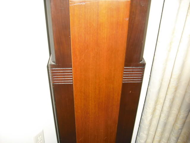

Here's some photos of my WR-8. I bought it a few years ago from a forum member in the Chicago area. I don't know if the finish is original but it looks similar to others I have seen. My clock is a newer replacement.

Finish is definitely not original, this was originally a two tone finish so it was refinished at some point in the distant past.

Thanks for the great photos Y2K Bruce. I like that two-tone finish a lot.
Maybe dark walnut toner on the sides and light walnut in the center?

The wood veneer is walnut, and the center section of the front face is another wood, which was finished lighter; almost a dark blonde. The walnut is finished in dark coloring, so if it's dark now, it's correct.
The front center section is wood screwed from the back and is easily removed, making the work and the finishing of the cabinet easier. There was a masonite back cover for these sets, and is often still on the cabinet. Yep, and how, the thing is heavy! It can be moved by hugging the cabinet, and lugging it around.
