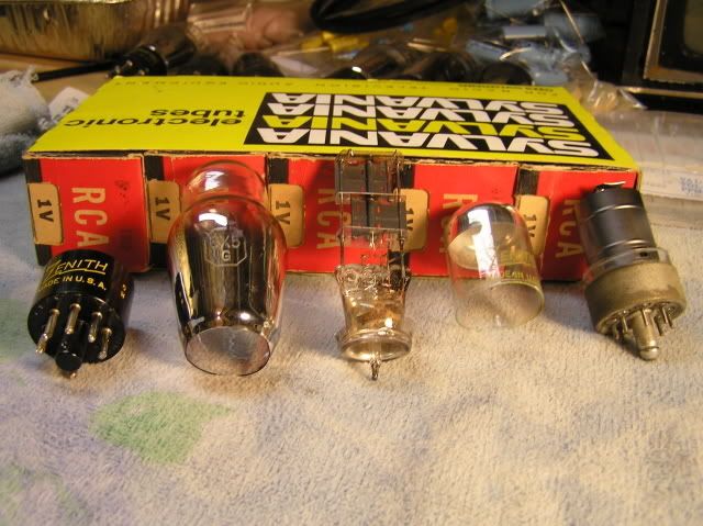

Your suggestions worked beautifully! Here are the results.
For my test setup. I used a low voltage transformer I had kicking around here. It turned out to be 30 volts A.C. at 20 amps. Yes it was overkill, but it was available. I connected it to my variac so I could control the current. I used about 12 inches of what looked like #24 enamel wire from an old tv yoke. I took Mikes suggestion and used a wooden clothes pin to hold the tension and put a one turn wrap around the locktal tube, being careful to slightly seperate the wires as they overlapped under the clothes pin. I connected the one turn loop to the secondary of my transformer and put the juice to it. Using an amp probe on the secondary, I dialed it up to about 10 amps. The wire turned red hot and in about 15 seconds I heard a tick and the deed was done. A perfectly clean cut with no sharp edges and no broken glass. Being encouraged by this success, I followed Mikes suggestion and boiled my 6X5G until the glue at the base was loose. I was then able to break the wires in the base and remove the envelope. I followed the same procedure to cut the envelope open, except for the fact that on this type of envelope, the wire loop wanted to slide down constantly because of the taper. I finally used masking tape to hold the wire in place while I put the juice to it. It worked fine, although the tape started to burn during the process. No problem! As you can see the cut on the 6X5G was fine, with no sharp edges, although it was not perfectly square because I could not hold the wire in place exactly. However, any variation in the cut is below the base and will not show anyway. This procedure is quick, easy and very reliable. Thanks to both Curt and Mike for their ideas.

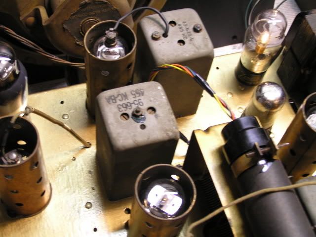

I finished my solid state 6X5G. Here it is in operation.
I used two 1N4007 diodes in each plate lead and a 150 ohm 2 watt resistor in series with the cathode. The output voltage is identical to that provided by the 6X5GT that I used previously. The light is provided by a #47 lamp which acts as a fuse/lamp. This radio draws about 70ma so the lamp lights about half normal brilliance. There is a turn-on surge when the filter caps charge, but it does not seem excessive. I guess time will tell if the lamp holds up. I wanted to fuse the B+ fairly close so I stuck with the #47 lamp. If it proves to be a problem , I can switch to a #44 (250ma) lamp. I secured the envelope to the tube base with G.E. Silicone II, using a small bead around the perimeter of the base where the glass of the envelope contacts it. It holds the envelope securely, but should be easily removable if necessary to change the lamp.
