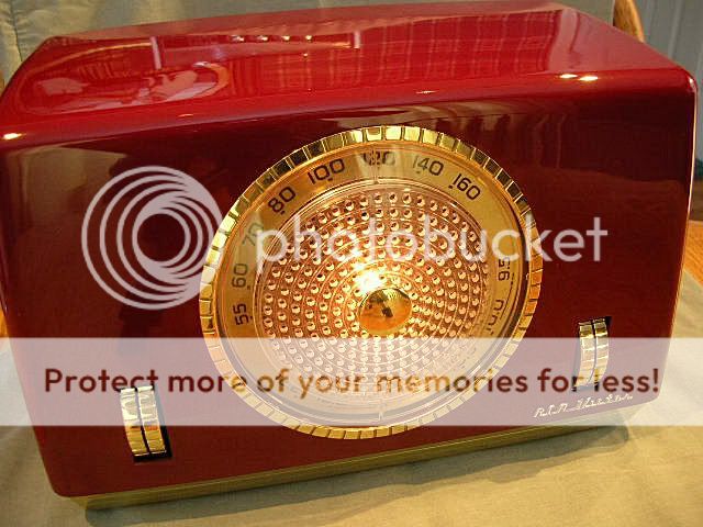

I repainted this Bakelite radio without stripping. I wet sanded it with 400 and 600 grit wet or dry paper, feathering all of the chips and scratches in the paint. I primed it and sanded again before the top coat.
This might not be so easy in a more complex cabinet design.

Doug VanCleave wrote:
Very, very nice !
